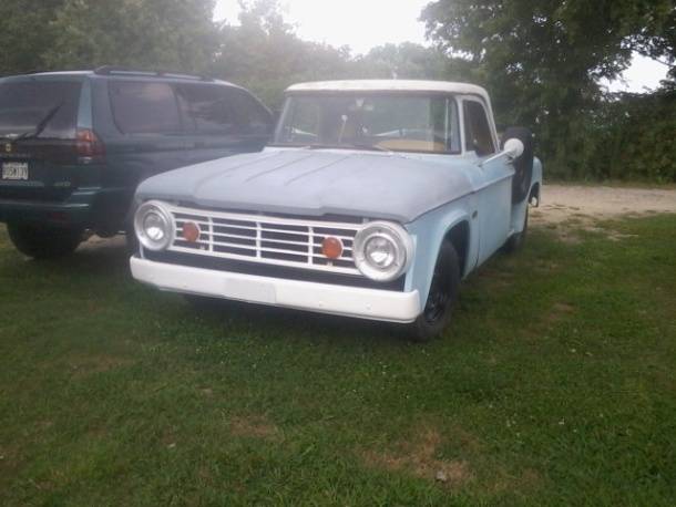

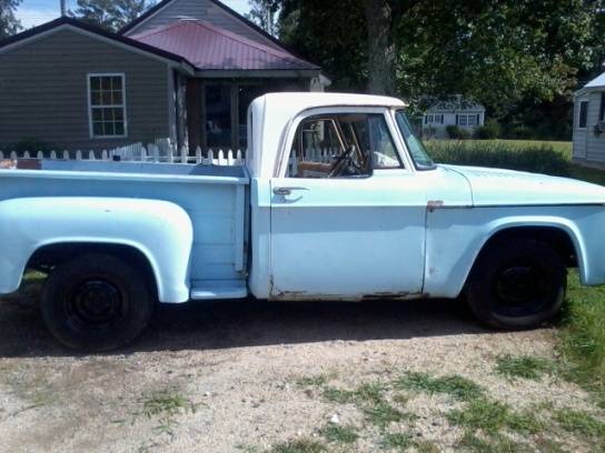

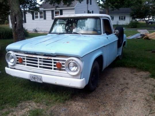

Greatings this is my First Post and Id like to Learn a little About this Old Truck I am now the Custodian Of. Its a 1965 D100 Step side. The Truck is Rough, But Runs actually very well and Has a Pretty interesting History. Its a 3 on the Tree and a Slant 6, She is a Ex National Airport FAA Luggage Truck. I have all the Documents since 1973 And has had a Fun and colorful history since then locally. This Old Girl Needs Rockers , Floor Board, Possible Fenders and A Hood if I cant sort the Original out. Well this is where im at a little Lost. I restore old MG's and such so this Girl is a little out of my Norm. Im having Issues finding anything other then the Rockers and floor panels and various little trim pieces. Is there and good Aftermarket Sheet metal suppliers? or other Options for trying to get things like the fenders and hoods and such? thanks for reading im a Total Noob at Dodges but I Love this truck and Refuse to let her get any worse. Please feel free to drop some knowledge on me. lol 130813_009.jpg130815_004.jpg
Welcome to the site "Choochoo" . Nice 65 you have there ! Unfortunately Your not going to find much for aftermarket body panels for her . Your going to have to work with what you have or find good used one's . I sell parts for 72 threw 93 Dodge trucks but if you want me to keep my eye's open for anything for your 65 then feel free to ask . But just to let you know shipping on stuff like that wont be cheap nomatter were you get it from . But from what I can tell from the pictures you posted yours look like there workable . How are you with metal and body work ?
Noy sure if my reply went to you but Thanks Bear. the Rockers and floor are no problem. ill sort them out soon. the Hood and door I gues ill buy time on with welding and a little body fill. I did find a front clip on Ebay so its a start. Linkage is my tackle this week seems easy. this baby seems like a tractor with a roof I love it its so easy compared to my MG's im use too it a nice change. the inside cab is still the FAA yellow from the original build sheet for the contract so im leaving it for historical sake plus it kinda cool. being in OC Maryland its the ultimate SurF Mobile . lol I got plenty of long boards the will be hanging out the back. Please keep a eye out any parts will be welcome. I definetly need from the doors Forward . thanks again and Anybody with More info please let me Know.

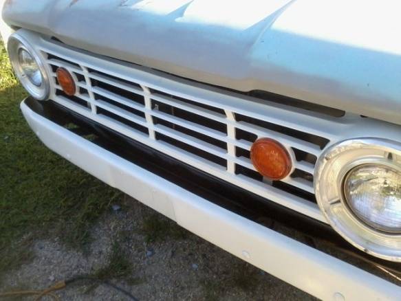

130825_006.jpg First stage of hood fix. I have a couple more places to sand out but im Happy. im so not a Bodyman so be kind.lol
Man, the only thing that ever followed me home was the ugly chick from a few houses down the street...nothing as cool as that truck, though.
LOL ..The More I Dig Into the bodywork the more I find this truck is more like a vette then a Dodge. Not a lot of steel under this paint.
