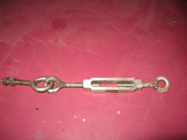

Here's a picture of the turnbuckle / This one is rated at something like 2700 lb's or so . But like I said , this would act like a safety strap or chain just in case you did blow a mount . One good thing about this set up is that it can be adjusted to . IMG_1563.jpg
I've used that same setup, you can adjust some slack so you don't feel any vibration. Jam nut one side to keep it from loosening too far.
If you wind up with solids here's a tip, Put a 1/4" plate on the bottom side of the drivers frame mount. I have pulled the factory washer faced nut through the frame 1/2 way around it on a 440 truck I had
Yah , This is the best safety strap idea I've figured out so far . Like bob said , as a bonus you can adjust it . Another tip is to weld the gap on the eye's togeather so they don't open up on you as well .
