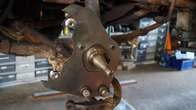

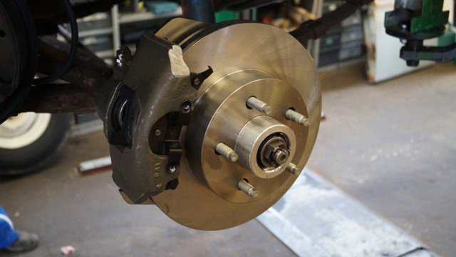

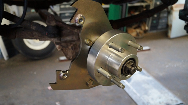

      I bought a conversion kit last year for my Dodge D100 58. My contact was Mark and the email scarebird@outlook.com
      The kit contains 2 adapter plates and hubs that fit the original spindle. Rotors and calipers are modern (Ford Ranger and GMC)
      I am very satisfied with this kit. Don't forget to dismount the residual pressure valve in the master cylinder if there is one otherwise the pads will stay in contact with the rotor and will heat.
