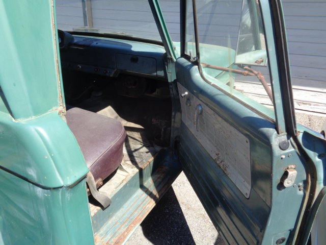

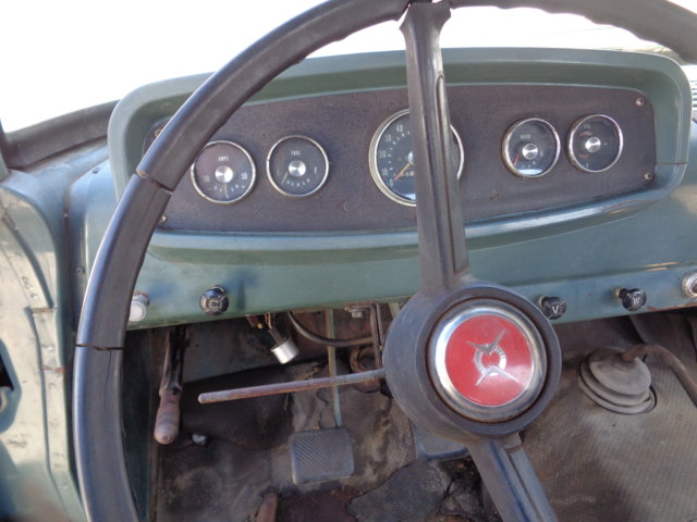

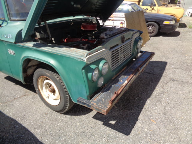

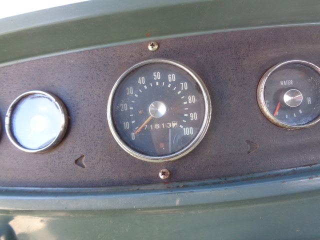

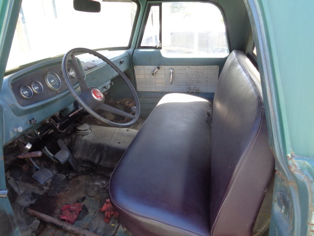

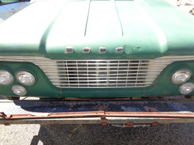

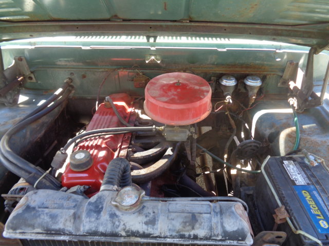

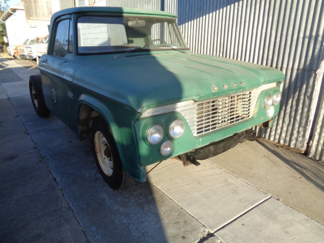

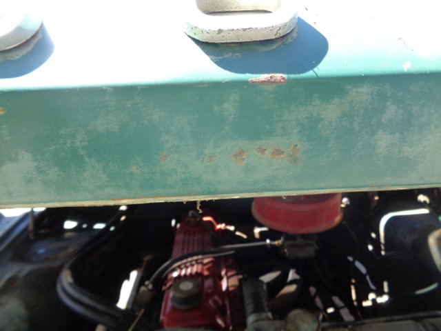

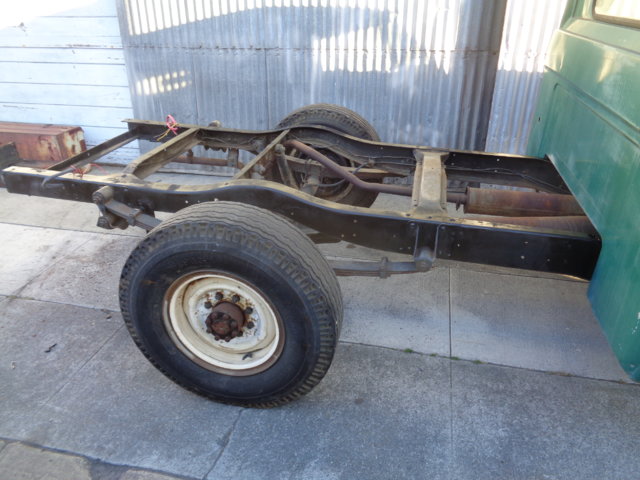

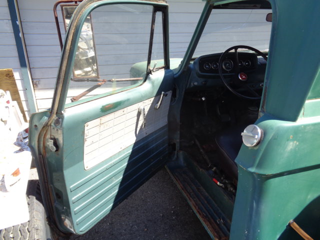

        doing my cab floor replacement a little different . just bought this 61 , it will fit or replace orangey's damage and her rust out . DSC01120.JPG DSC01121.JPG DSC01122.JPG DSC01123.JPG DSC01125.JPG DSC01126.JPG DSC01127.JPG DSC01128.JPG DSC01129.JPG DSC00847.JPG

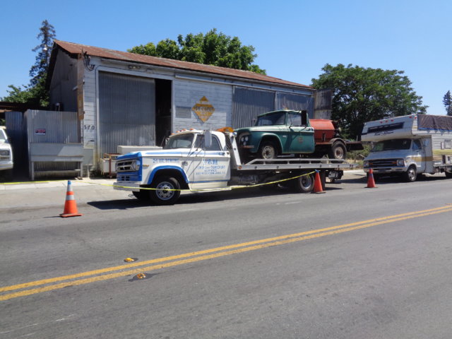

            thanks its home now , now the real fun starts .

              Looking good man!!!

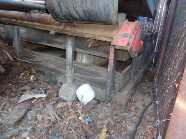

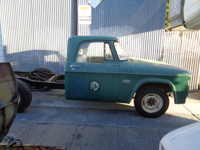

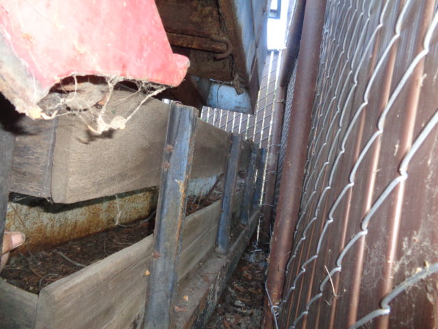

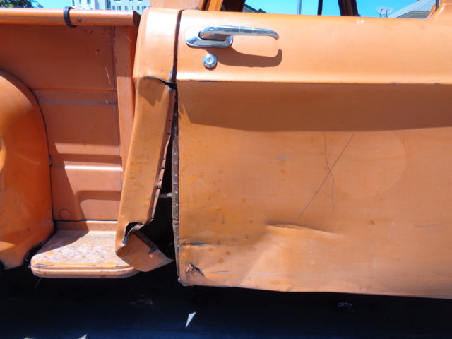

                  hey , my cab floor change is going well , this 61 d200 /6 runs to good to hotrod yet , going in a different direction . i need a truck for rental repairs from time to time . oh ya peeled those elephant ear mirrors off and all that tank n spray rig from its welded frame mounts , so i'm flat bedding with short side racks . and of course its berried under another n more . just a fork lift away , lol . DSC01414.JPG DSC01415.JPG DSC01416.JPG DSC01417.JPG DSC01418.JPG DSC01419.JPG DSC01420.JPG DSC01422.JPG DSC01423.JPG

                    Nice work Paul. :)
