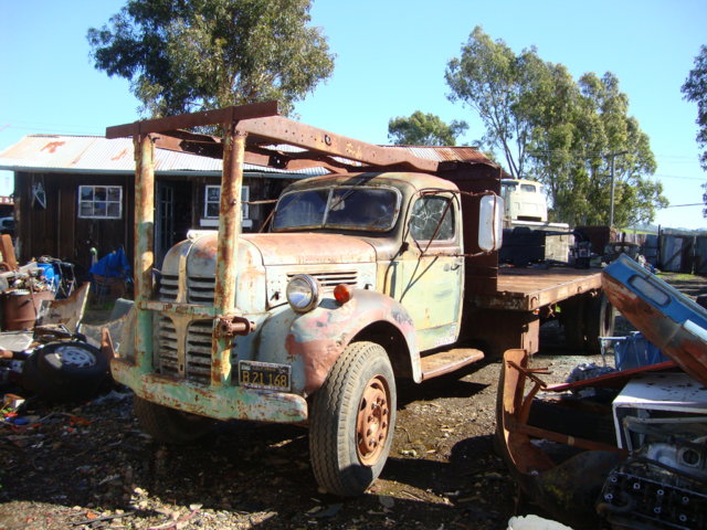

cummings and dodge truck lines have been together since the fifty's i think . the fourty's fargo and larger dodge haulers had big flathead 6 gas engines . i now this truck has a gas powered 413 high nickel flathead six in it . and the fifty's saw the chrysler hemis in dodge badging , but i thought the inline 6 cummings took over for these monster gas 6's .
