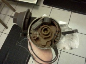

The thing is totally rusted on the inside. I was told to try a MSD distributor, but seeing as how the motor doesn't go with the truck no one's been able to help with that either.

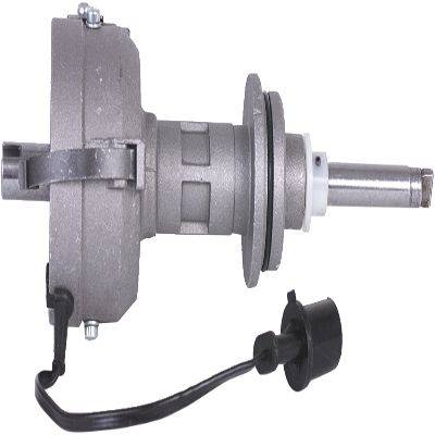

dist. 3.9.jpg Does it look like this one ?

Bear..... I wish it did look like that.
All of the available Cardone's are to short in one way or another or don't have the right insides, hence my "wits end".

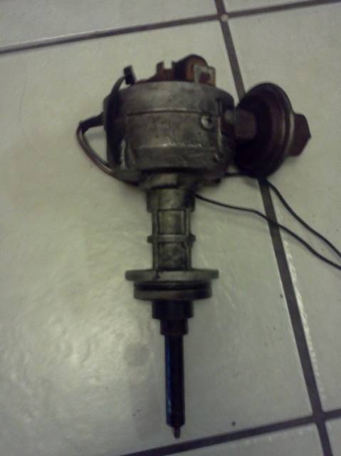

Took some pics last night though, so sharing like I should have done in the begining.
Like I said, the truck worked fine without the vac advance, so I'm not to worried about that.
The rust happened after someone I no longer talk to, told me they knew where to hook it up at....and as you can see they didn't, because it rusted out the insides and now I'm in this mess.

They've been to short in the casing and in the shaft, and if you compare my pic's to the one bear posted you'll see it's also to short in the lower part of the casing as well.

The casing being shorter is ok. The shaft length going down in the block is what matters. The dizzy will just be a little lower profile. My buddy actually had to shorten his dizzy to put a 340 in his 63 dart

Neighbor suggested I try cleaning off the rust......may have to try that although I'm not sure I want to.

I can get you that Cardone part number but that's the same one as I showed you a picture of . My supplier say's he doesn't have it in stock but he can have it in one to two days .

You can tell from the picture that the other guy had swapped the plug so match it up to your old one and use that plug and just wire it the same as he did .
