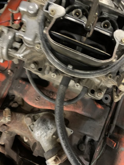

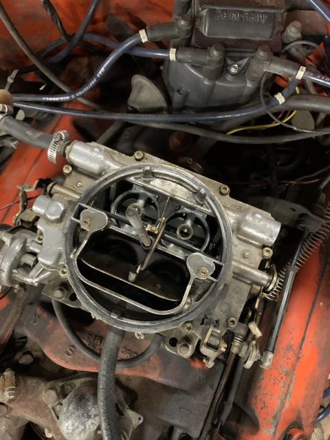

I installed a pressure regulator. The fuel is not boiling over. It is a used carb and looks dirty. Perhaps I should remove, disassemble and clean?
In terms of the cam, not really sure - I purchased the truck about 2 months ago. My guess is that its stock.
I have a DELCO HEI.
Thanks!

I wonder what jets and metering rods are in the carb? If the previous owner maybe changed them out and richened it up too much. I think Edelbrock has a chart as to what jets are stock for the 1406 and how to tune it with different jets and rods.
