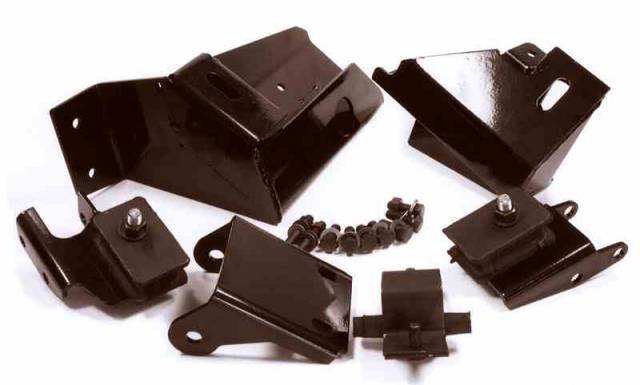

I don't know why I didn't think of this earlier, was standing 2 feet away from the catalog. Schumacher Creative Services has conversion mounts available. Not cheap, $395 + 40 for shipping. Your LA will drop right in. I have their mounts for my Dart and just got a shim pack for my Polara. Great products and great service.
Here's a pic from their website for your mounts:
Call it being a tight wad or just to old school i just do not see $400 worth of value here. Or just to many engine swaps with home fabricated mount. But if you do not have fabricating capabilities or the equipment this could be a bargain.
I agree with the cost factor. It's $200 for my Dart and it beats paying way too much for a beat up K frame for a v8.
I wonder if the frames are th same and the mounts are the only difference. Maybe go out I a local junkyard and pirate mounts off a wrecked v8 Dakota
I don't have any fab skills or a welder (hence the no fab skills) so if I was doing this I'd probably go that route. Just trying to offer some options, but yeah, not the cheapest.
