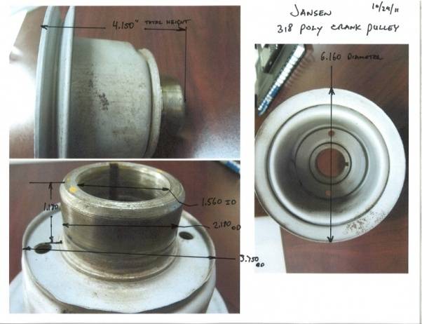

I have a '62 D100 with a Poly 318. I'm looking to add an air conditioner and need to swap out the crank pulley to a two groove pulley from a single groove. The stock crank pulley on the early truck engines in not a harmonic balancer style, see attached pictures. My question is, can I use a a later style harmonic balancer that have two-grooves and not damage the engine?

I assume the engine is internally balanced, since the stock pulley is not a balancer style. I'm wondering what effect a balancer will have on the engine and will it cause any long term damage. Hope to get more feed back from the group.
