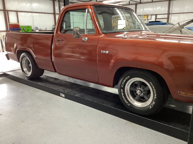

hey guys, Im a car and truck vloger, car and truck enthusiast, planning next week make some content, can you share with me what kind of truck do you have?
1980 model d100
Regular cab short bed
Running a 383 magnum and 727 combo
With a 8.75 rear w/3.55 gears.
