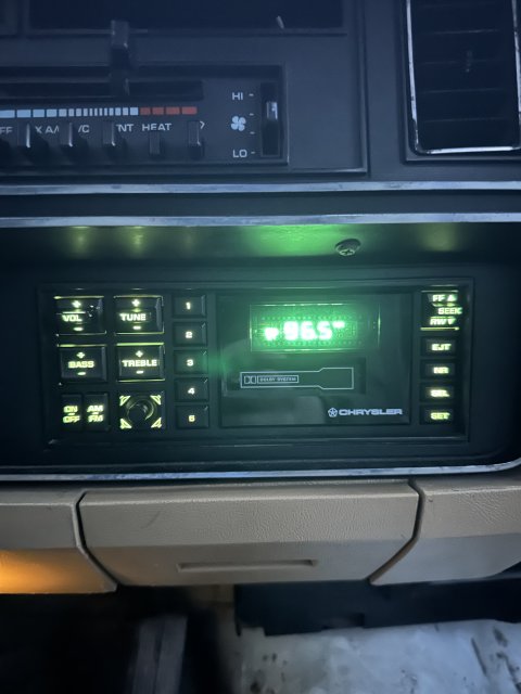

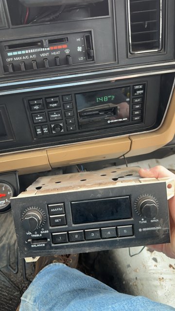

Hello everyone,
I know this is a very old thread but I figured that I'd update it now that I finally had the time to finish this project.
Attached are a few photos of the radio I ended up swapping in. It came out of a '92 LeBaron. Part # is 4469314.
There seems to be 2 versions of this style of radio. Both versions have the typical rectangular black and gray connectors on the back. One version has an additional round connector and an additional square connector. The other version (that I ended up with) only has the extra square connector. I don't believe these trucks have anything to connect into these extra connectors (or even what they were for originally to be completely honest). Either way, mine seems to work fine without the extra connectors hooked up.
In my opinion, this radio looks quite a bit cleaner than the original. It sounds a little better too. But obviously still not great by modern standards.
If anyone else wants to do a swap like this - it seems like most radios from 1981 thru 2002 will fit these trucks. The swap itself is super easy. It didn't take me more than 15 minutes. That being said, if you want good audio quality, you would probably be better off replacing the radio with an aftermarket unit. I just prefer the look of the old Chrysler unit over a new aftermarket radio.
