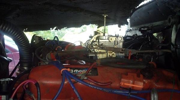

Anyone with a Big Block, can you measure how much space you have between the top of the carb to the bottom of the hood. Also include what intake manifold, carb and whether its a B or RB engine. Thanks.
about that much room
ok 1984 d150 2 wheel drive 383 b block i got 6 1/2" top of carb to hood insulation there maybe a extra 1/4" hood was setting flat on cowl no front fenders on. 10 1/2" from intake carb mounting to hood. i have a 1" spacer block under carb so you could say 7 1/2" with out spacer from where air cleaner sets on carb. carb is edelbrock 600 cfm.
