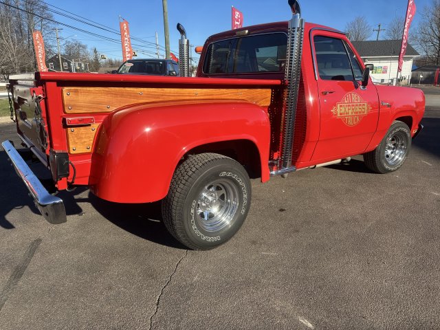

Looking to buy a set of headers for my 78 LRE I can by a set of Flowtechs (ceramic coated) for slightly more than a set of Hookers uncoated. Any thoughts? Plus does anyone make a good set of transition pipes to tie into the factory stacks from headers?
Thanks
My 1st question is do you REALLY need them? A few thoughts - if you are stock you will only gain about 15/20hp, they make it VERY hard to tie into the factory stacks (thanks to a gas tank sitting along the drivers side frame), and will most leak at some point. But if you are sold on the idea I highly recommend Hedman Elites - not cheap but they fit great and look great for a long time. As for tying into the factory exhaust, just get with a good local exhaust shop there is nothing off the shelf that will bolt in.
I am keeping all of the stock stuff together, but thinking of using a 408 stroker in there for some fun and the headers would work better with that combo but not loose the stacks (factory look). I seen a video on YouTube where the guy made his own exhaust (3”) and did an awesome job. You would think that someone would make a kit I would imagine it would be a popular request.
10-4 - I did the same for a few years and yes with the 408 I would go thru the trouble of getting the exhaust done.
As for a "kit" I would say you are highly over estimating the size of the marketplace.
