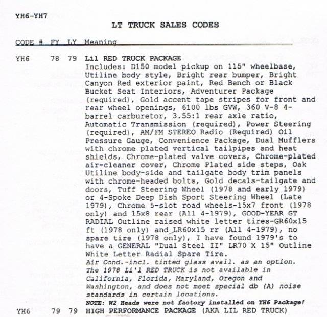

FWIW, my son and I owned many Warlock (when nobody want them) so when it become available I bought that little book from Galen Govier.
As you know, YH6 is the sale code for the Lil' Red but it didn't gave the code number for each options. It just say: ''Gold accent tape stripes for front and rear wheel openings''

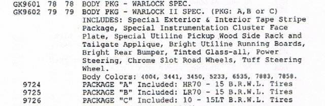

Warlock sale code is GK9601 for 1978 and GK9602 for 1979 and it says: ''Special Exterior and Interior Tape Stripe Package''.

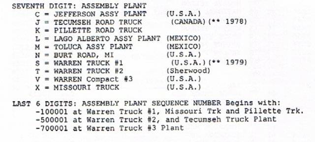

In 1978, the Lil'Red were built in Canada: 2,188 for USA with 360 cu.in.
2 for Canada with 440 cu.in.
In 1979, all 5,295 Lil'Red were built in the USA with 360 cu.in.
Needless to say we search hi and low to find one of these two 440 Lil'Red, but with no success!!!
Serial # D13BD8J 504891 and 504894

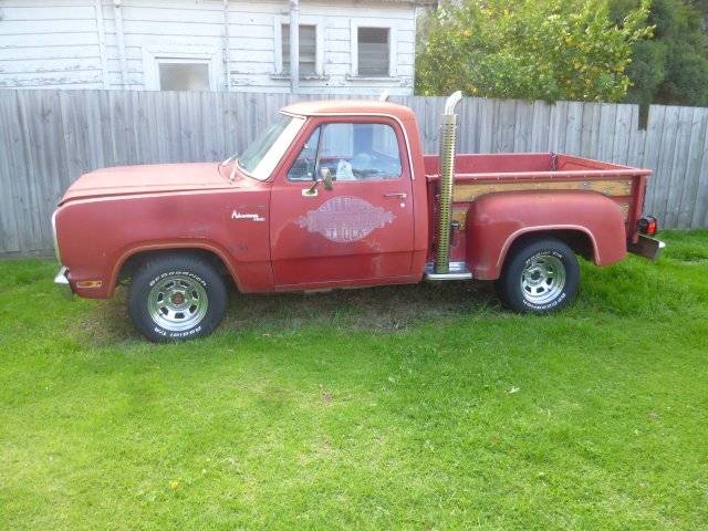

All the production trucks had an aftermarket exhaust system essentially?Since a vertical stack exhaust system for the Lil' Red was never released by the factory

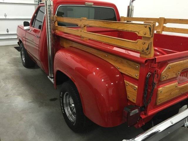

The factory literature supports the stripes being original. And they are slightly different than the Warlocks. The extra wood in the stake pockets is not original, as far as I'm concerned. Yeah, they'd remodel your kitchen to sell a vehicle. Any color whatever option, you could get it, albeit sometimes you went through a lot to accomplish that goal. Now you buy what they want you to buy.so why not extra stripes and the Warlock woodwork
Sorry, what I should have said was a 440 vertical stack exhaust was never released. All of the E58 trucks had a factory installed exhaust.All the production trucks had an aftermarket exhaust system essentially?
I like the woodgrain extra's sets BOTH trucks off nicely! Now is that a "dealer" offering to make the sale or could you (back then) custom order that for the truck you were buying? As sometimes, I think we all forget that way back when, you could special order where as today, forget it, unless its aftermarket..... The OEM factory doesn't do the "special order" thing anymore.... Which is sad in a way, BUT also would require a LOT more employee's to do so making cost a bit higher to pay for the item! -Like Mob said, you buy now, what THEY what you to buy!
What was the difference for the 440? The 360 got 2.5" stacks, did the 440's get 3"?Sorry, what I should have said was a 440 vertical stack exhaust was never released. All of the E58 trucks had a factory installed exhaust.
