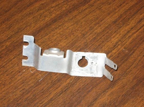

Your "still" having electrical problem's ? Ok lets start at the beginning . You changed the headlight switch . Have you checked for voltage in and out of the switch ? As well as down at your dimmer switch ? Also does your switch have a ground plate and if so did you plug it back in when you changed out the switch ?
IMG_1415.jpg If your not sure what the ground plate looks like then this is it . It go's between the switch and the dash board .
Yes mine has a single blade ground connection , I connected a ground wire from grd. plate to - on battrery & still no lights "eternal vigilance is the price of freedom"
Ok , Have you checked for voltage in and out of your switch as well as your dimmer switch ? If you have voltage in and out of the switch's then the next step would be to go to each light and see if you have voltage there . If you do but the lights aren't working then that tells you it's a ground problem and if you don't then you'll have to check either side of the bulk head .
