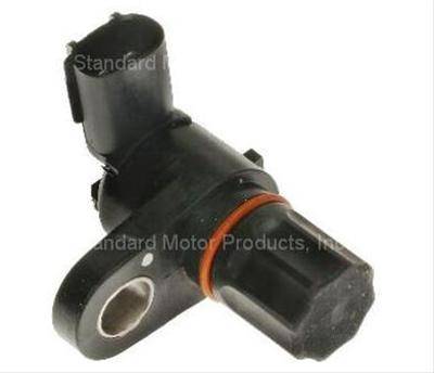

Sounds like you found it... I was going to suggest the maybe the Rear Axle ABS brake speed sensor on-top of the rear end housing, I had a similar issue on my 99 SLT Dakota 4x4, it was the speed sensor $70 @ Summit Racing or Napa, my speedo didn't work until you got over 35mph, but had no tach, the yellow abs light stayed & brake warning light stayed on IIRC for some lame reason thru the computer everything in the dash cluster goes thru that sensor, you may want to check it too, since I have no Idea what year yours is...
