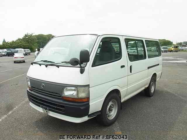

My shop hack is a Toyota Hiace which is similar to the L300... (similar to this one)...

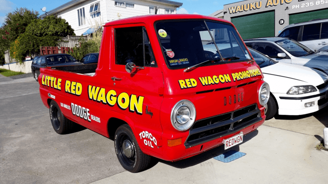

Bill Maverick would bring the real Little Red Wagon to a little thing we had the next town north of me, Motofest. He would do wheelstands down main Street. I heard about it but never made it down here (I lived 2 hours north at the time) til I met this gal I'm still with. Wish I could have seen that.
i also would loved to have seen and heard the LRW and "Hemi under glass" in person. Both unique vehicles and awesome for MoPar to have them both as show ponies. :cool:
I have had the fortune of seeing them both at the Mopar Nationals, both guys were very easy going and personable. Bob Riggle was coaching a newer wheelstands on how to drive during the runs. That was cool to see a legend coaching a new guy carrying the torch.

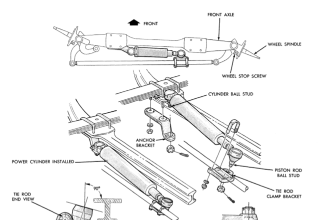

I just found this in the supplemental manual - for trucks with 7000lb load rating.
