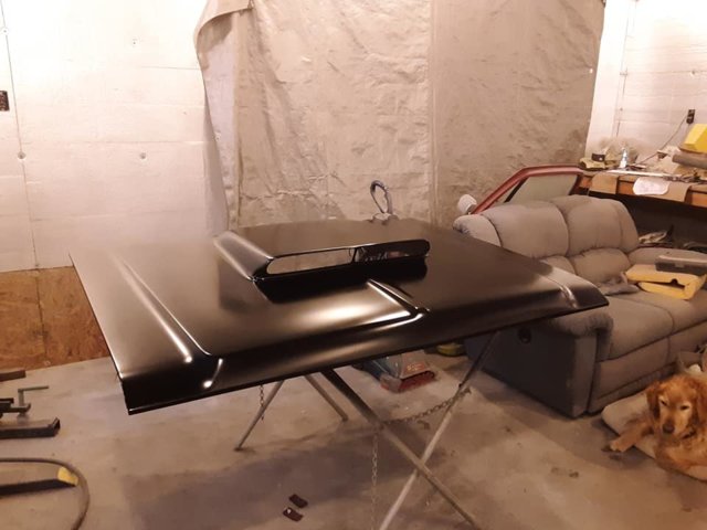

I'm slowly getting my dually ready for paint and managed to get the hood done after grafting in a six pack scoop. The truck is and will be canyon red. I snagged a set of black leather buckets from a 2014 Laramie last year at the Mopar Nats. Slowly coming together

This must not be a work truck. That black leather will be warn this summer but will look cool.
Yep. 12V cummins, 5spd. I was looking for a 4BT to swap into the truck in my sig but found the 92 for less than the 4BT was going to cost. It was an IA farm truck that drug a 5th wheel to FL every winter. No rust but beat to death inc 5th wheel dropped on the bed. The PO had also spent more on the truck than he was asking for it. Love it. It's a hoot and gets low 20s mpgs. It's the only 1 ton hot rod at most shows too. I still have an itch for a 4BT so time will tell. I'll post updates as they happen but most likely in a new post as I move slow.
