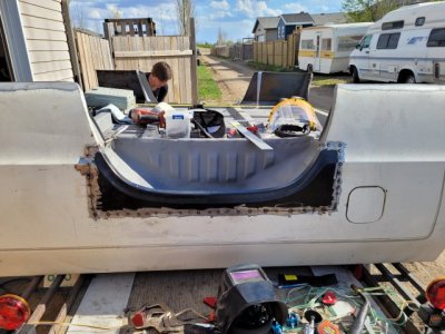

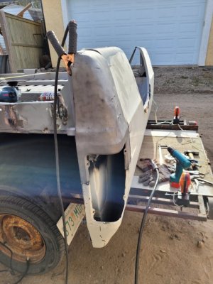

89 W150 for my son!
A bunch of photos in no particular order. We are into bodywork right now!

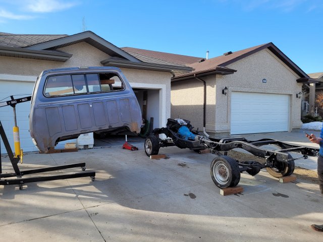

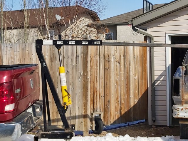

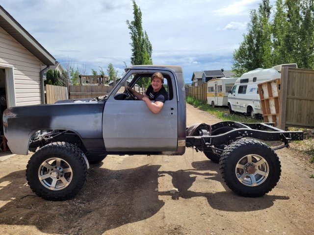

Hey 89, how did you remove your cab without a gantry or lift. I saw In the background of one photo you had an engine hoist inside of the cab.

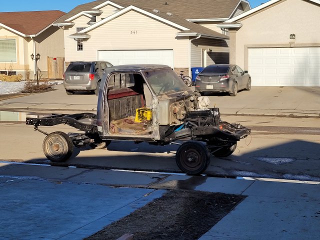

A buddy and I did a body swap on his truck. He lifted one side of the cab, I blocked, and with the bed already off just rolled the frame out from under.
The first pic is how I lifted it off. Worked good for the bed but it bent the reciever hitch mount I welded on to the engine crane when lifting the cab.
The second pic is how I reinstalled it. I welded up a bracket to bolt to the engine crane and attached a 4x4 post to that. Not a real good picture but unfortunately it's all I can find

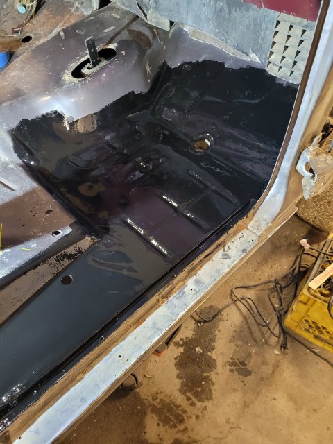

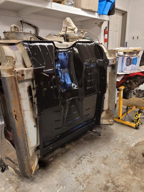

Thanks 89 much appreciated. I was thinking doing It old school with a bunch of friends but, being In my 50's as well as my friends life gets busy. Getting 1 of my friends to help me Is hard enough. Trying to get 4-6 Is a mission impossible episode. This will help a bunch. By the way It's looking really good. What did you use on the bottom of the cab rust bullet?
