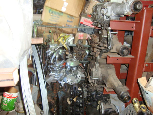

that a simple interchange , the steel forks will work if you cut the reduces portion from them . it will shift better after you swap them as well . thats been a commen mod for the later shift side plate for years . i think that a b body shifter non console type could do the trick . see that one is from a 68-70 b body , roadrunner gtx charger coronet rt superbee ect.....
that a simple interchange , the steel forks will work if you cut the reduces portion from them . it will shift better after you swap them as well . thats been a commen mod for the later shift side plate for years . i think that a b body shifter non console type could do the trick . see that one is from a 68-70 b body , roadrunner gtx charger coronet rt superbee ect.....View attachment 16533
Oh awesome, ill pull the trigger on non console B body shifter mechanism and its components
that should work , if not i have a mechanism from a late 70's early 80's from an od a833 as well as the glass hump for the cab floor .
