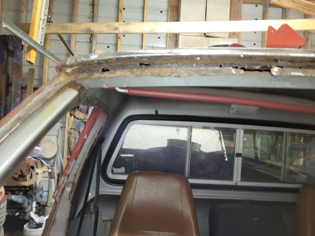

I am working on repairing the drip rail on my truck and it seems like the roof skin was not welded to the windshield frame.
Or....
The rust is a lot worse than i thought.
Does anybody have experience with this?

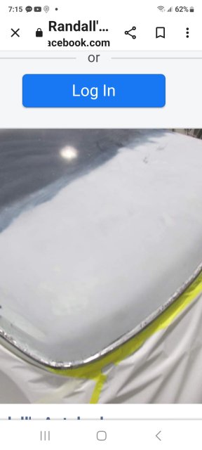

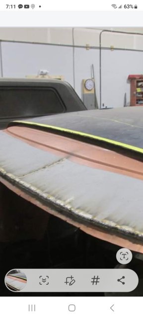

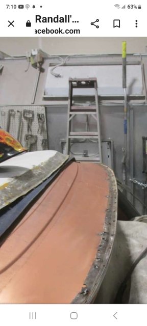

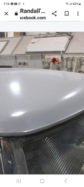

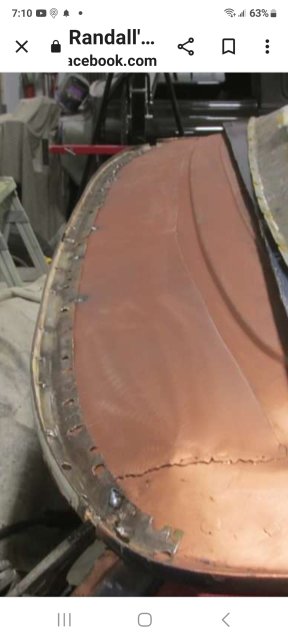

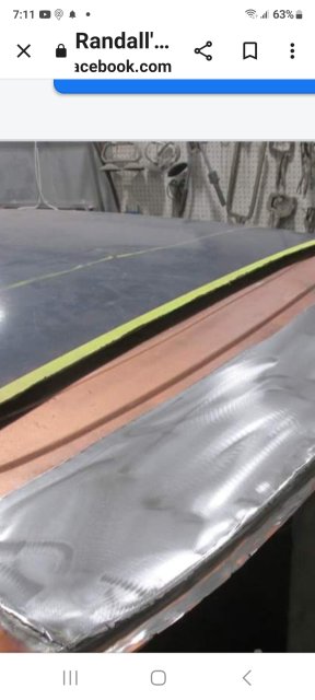

These are some photos from a local body shop that just did one, this guy also painted my 56 recently. Lots of work he put into this old truck.
In this case they couldn't find a doner so they patched it, but it came out nice.
The strange part is that there are only a couple of pinholes in the skin itself.
The rail is rusty, but whatever fastened the skin to the window frame is no longer there all the way across
I'm guessing the water entered maybe through a weld or some old seam sealer then the two layers just separated??
