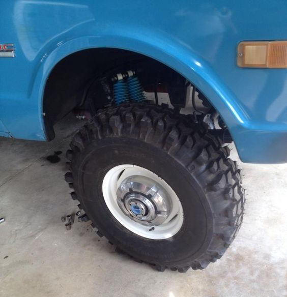

I'm going thru the same thing right now with my 77 M882. I decided to stay with stockers with some Interco Narrow super swamper TSL. They end up up at 33.8" diameter. I looked high and low and everything in 8 lug is either ugly as F or you have to go to 17+ in diameter. Just look, look and look some more. Here Is a pic of them on a GMC.
