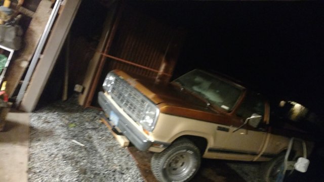

Hi guys, my first time over here from forabodiesonly. com . a 73 duster was my first vehicle and I still have it and did a part by part restoration of it. It's time I feel to up the ante, I'm doing a frame off Dodge pu.
The truck: 74 w200 long Ben single cab 360 205 auto truck.
Parts truck: 89 w100 single cab moonroof 360 np435 203 A/C shortbed no title.
The end result plan is, which may change if I have a better plan or you do is:
74 w200 360 np 435 203 modified to not have full time and + gear vendors behind it. I plan to take the cab from the 89 aswell to have a moonroof and all a/C...
I will definitely take advise, and hopefully parts sourcing aswell! Thanks guys!

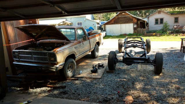

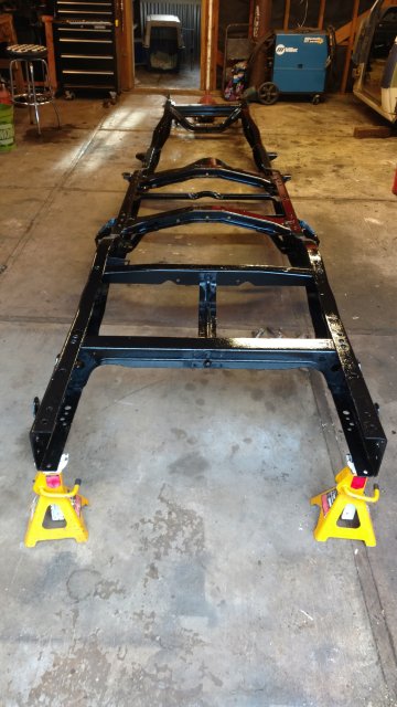

I have been making slow progress on the chassis but I now have it all clean and painted with por 15.

Got the chassis rolling again. Next steps are to put new brake lines in and fuel system ( I'm thinking dual saddle tanks . taking apart the 79 today to sell the engine and start getting the cab off shortly.

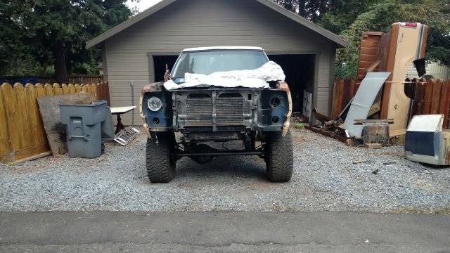

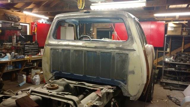

Cut a foot off each side of the radiator core support and welded on 74 year headlight sheet metal to replace the square headlights with round headlight buckets.

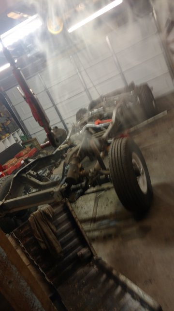

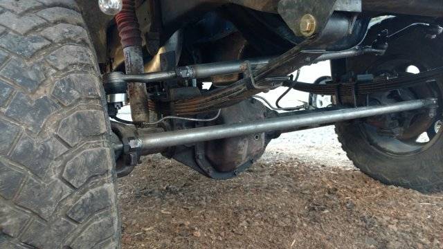

Took the Dana 60 out of the front ( 4 linked that into our crawler project) . Put a Dana 61 in the front of the truck. Also replaced the 14 bolt rear end with a limited slip 70.
Did crossover steering in the front. Just for the record if someone is planning on doing this. Your truck must be lifted for the added cross over steering tube to make it under the engine cradle without bending it. Also if doing this to a 4wd truck you must move the steering box to the 2wd position which is very easy to do as the holes are drilled for it already. This is necessary because in 4wd position the pitman arm(?) will hit your frame. Check for cracks in your frame, as mine and so many others are broken there. I boxed and sleeved the frame right there for additional support. Don't bother looking for the premade frame boxing kit, as I did and could never find it.
If you need the parts for doing a crossover I got mine from WFO concepts here in northern California where my brother in law works. Every part was correct.

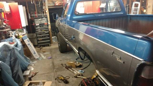

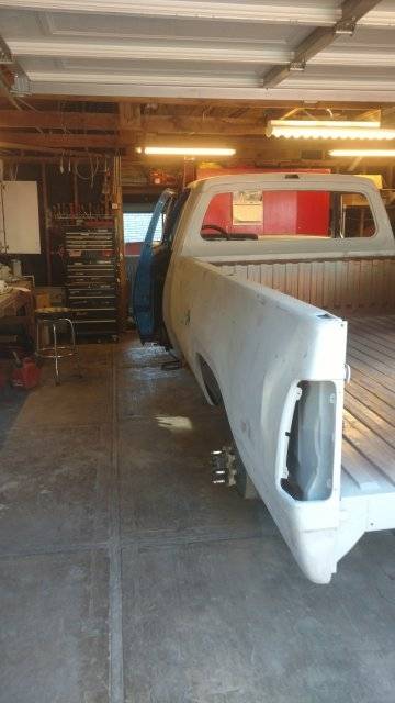

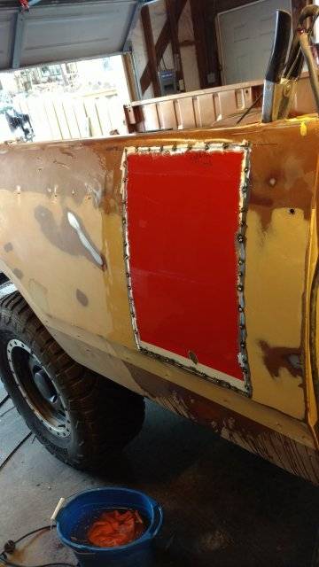

Then added a 72 bed and 74 doors, grill, and fenders.

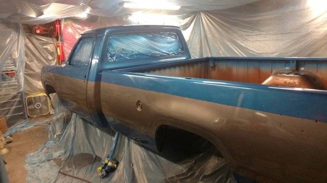

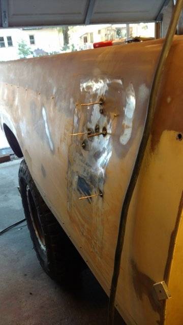

Lot of body work.

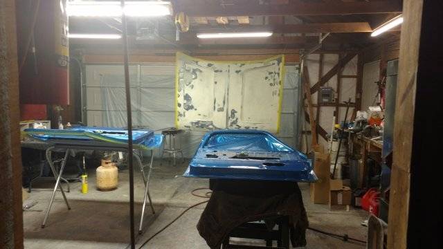

Paint.
Still plenty of little things to tackle but progress is being made on my learning curve.
