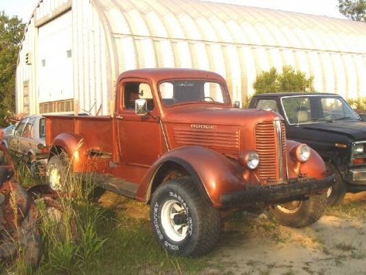

See how the center of the brake drum sticks out on the front of my truck? If you have a center hub on your rear that extends out like this,just remove the bolts from the center,pull the axle out,then remove the two VERY large nuts that screw down over the end of the axle housing on each side,remove the bearings,and pull the drums off by hand.
