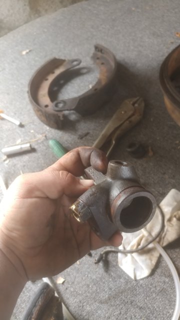

Need some help getting the brakes bled on my truck. The drivers side rear will bleed just fine but passenger rear won't at all. Im getting free flowing fluid all of the way up to my top wheel cylinder but it won't come out of the bleeder valve. Ive taken that cylinder off and nothing seems to be blocking any of the fittings. How can i try to get fluid to flow through this cylinder?

Is the bleeder screw clean? The line from the lower wheel cylinder to the upper is open? From your post I am assuming it has a upper and lower wheel cylinder each with one piston.
