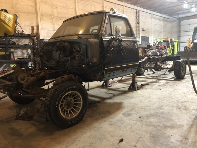

I have just started the assembly of this project. I have a lot of questions, so I don't have to find out the hard way. I am using the suspension from a 1986 Ramcharger, the frame and body of a 1985 pickup, and the motor, tranny, and transfer case of a 1974 Power Wagon. The front end is about complete and I am trying to get the right bushings for the rear leaf springs now.
