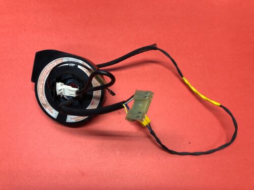

The truck has a air bag? They use a clock spring in between the column and the steering wheel, it could be bad.
Looks like this
I may try that. Like i said. The horn doesn't even click, and the cruise control light on the button comes on, but cruise doesn't kick on.
