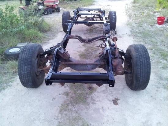

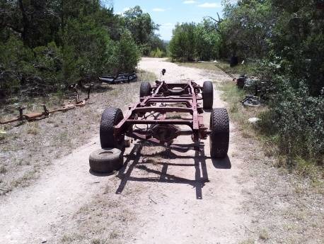

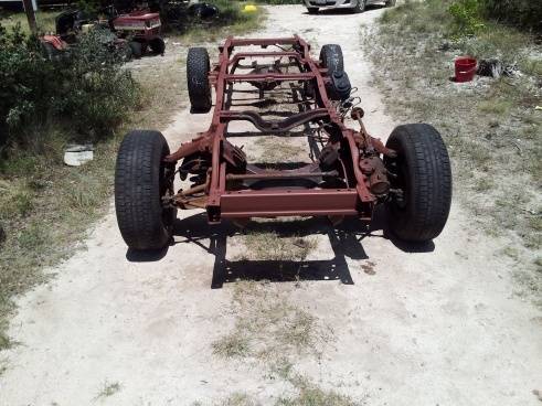

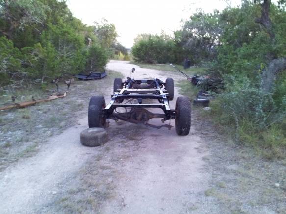

Here's some pics of my new frame primed,and painted.
WOW ! That look's like a clean frame ! Good idea taking care of everything now , then you won't have to worry about rust issues later . Plus , I'm the type that hates "just" fixing thing's . Or putting grubby , rusty parts back on something . I'd rather spend the time to clean things up and paint them up while there off . Even if your not restoring the truck , after your done you can step back and say "yah" I did that . Keep up the good work and keep us posted .
