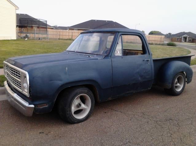

Here's a pic of the truck... I fell in love with it for the fenders alone.
