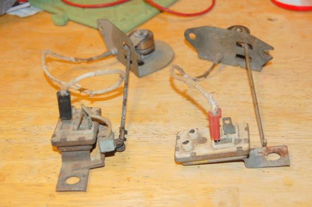

My dodge pickup has a wire coming off the choke thermostat which is mounted on the intake and I was hoping someone had a picture of where it plugs into. I have looked high and low and cannot find the other wire that it plugs into. If anyone has any leads please let me know. I will try and post a picture this weekend.
I don't have a photo of one right now, but the wire from the choke plugs into a small rectangular ceramic looking thing maybe 1-1/5"X2"X 1/2" thick. It will be bolted to the engine manifold no more than about 3" away from where the choke shaft come out of the manifold. On the top of this little device are two spade connections, one says battery and the other choke. On the side of it is a small square resistor maybe 1/4" square and 1" long. Teh wire from the choke heater plugs onto the "choke" terminal, but I can't tell you what color wire is connected to the battery connection. My running truck does not use this device and the one that does is scattered in about a million pieces across the farm in three different sheds.
hanks bikinkawboy. I need to post some pictures on here. That choke heater control is apparently missing on my truck.

Here's photos of the choke heater control. I believe the trucks use the one on the right without the resistor. Can't remember for sure, but the resistor one might be used on cars. DSC_2074_01.JPGDSC_2074_01.JPG
