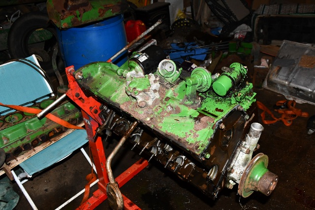

I've been wanting a simple vehicle so I've decided to mostly convert my Adventurer Sport into a regular old custom, with that will come a 4 speed and a Slant 6 from a 1972 John Deere 800 series swather. I'm rebuilding the slant to have a bit more power, but the name of the game for me is fuel economy.

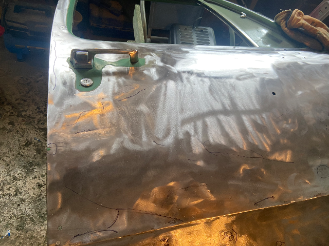

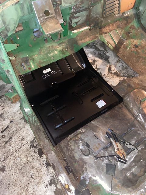

As it sits the body is completely disassembled and paint is getting stripped. I've found many more dents and much more Bondo than I had hoped for but overall it's solid. It looks like I'll be able to save the doors, though fenders, hood, bedsides, and tailgate will almost certainly have to get replaced.
That slant 6 from the swather is a cool choice for better mpg - I ran one in my old Dart and those engines will run forever if you rebuild them right.
