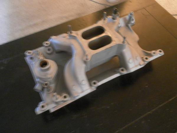

Direct bolt in All you need to do basically is what I've outlined above. You will need a LA 360 drivers side motor mount bracket. If you're not going to run A/C use the Crosswind intake & use the money saved to buy a Moroso under drive pulley. A bunch of that 5K can go towards rockers & springs gears & such. Here's a pic of my Professional Products Crosswinds intake. They fit LA or Magnum engines & are $160.00 delivered on Ebay

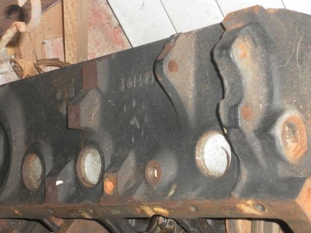

They have both Bear here's a 3/14/98 block that's sitting on my back porch
Hhhhhmmmm , now I'm gunna have to take a look at my 97 . I wish I had known that when the motor in my 95 let go because I have a 89 roller 360 sitting here with only 70,000 on it and everyone kept telling me that because of the motor mounts I could'nt use it .

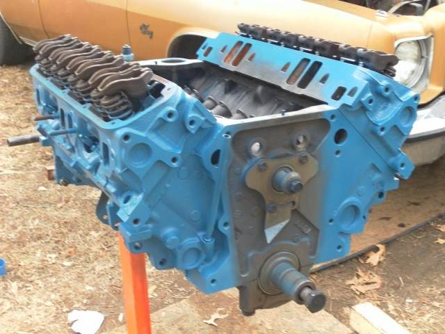

Here's a LA with Magnum heads that I'm doing right now for 75' Fury wagon with 59K
1989 is an LA engine that uses the front mounts in the block that is pictured on the first page, it doesn't have the magnum mounting spots for the 1995 so it wouldn't of worked as yours bolted differently,
now that being said magnum engines will bolt into the factory LA engine mounts and work fine

Better head flow,roller cam, 300 horsepower made by just adding a carb no smog needed except for what your state requires for your truck. your LA stuff will bolt to it except for the intake. To use your stock fuel pump you will need a cam snout extension kit from Hughes Engines I buy mine from Mancini Racing. I swap everything to Magnum engines that I buy almost. The only reason for the head swap on the wagon is that it only has 59K original miles
I relized that "79dodge4ever" when I looked at the picture and then looked at the 89 360 I have in the garage . I can go one way but not the other .
