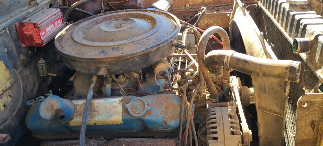

Just joined up here! Have 1971 D300 utility 8' flatbed w MH 440/727 combo. Made some small durabilty/drivabilty changes in 2000-2003! Trk came w propane 318/ 4spd(wish I'd kept this)w 5.13(?)diff gears. Added oil cooler/trans cooler, dual 30gal tanks, 50gal transfer tank, Sumitomo 8R17.5 tires/wheels (MH), Edelbrock dist/850cfm carb, Mallory ign! It's been parked in a friends barnyard since 2010 when I sold 5th wheel! Having it transported here this month. Will continue w eng mods/mechanical improvements etc once it's here near my shop! I was prof auto mech from 1970-1985. USAF 74-78. No photos now! I'll take some pics Thurs when I go to get it sorted 4 transport!

Thanks all! Yes, it uses gas! Pulling my 36' 5th wheel did about 10 mpg. Don't plan on driving it much. P/u heavy/long stuff at Home Depot etc. May do some commercial towing! Many things to sort starting w radiator rprs and carb clean 2 get it started after 14 yrs! MH 440 showed 27k+ miles when installed. 1976 MH had been sitting for some years! Compression is only 95-100 across cyls! I'm suspecting stuck rings! I'll dump some Marvel Mystery oil in, crank it a bit then let sit 24 hrs. Maybe I'll get lucky! 2192 Edelbrock cam kit and dual plane 2191 Edelbrock intake man. Have the 1⁷/⁸ headers already. Anyone have experience w this combo? That is...planning on this cam/intake.
I'm running the intake with a .484 purple shaft cam, 1 7/8 headers and 3" pipes out the back in my '66 Polara, it works nice for what it is. I get 13.6 @ 70 with a 275/60/14 and 3.55 8 3/4. The block is stock (other than the cam) from a '77 New Yorker, so same low compression.
