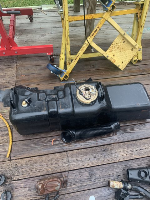

Yes, a plastic gas tank . Looks like this below…

We have mounted a 93 tank into a 74 frame. So don't know why it would not work the other way around. I would save the straps from the older tank.
Good Morning I have done the opposite 91 tank in my 87 when I converted to FI. They interchange as far as mounting, the sender is different in the resistance for the gauge to work properly. On my 87 with carb the fuel lines run on opposite sides of the frame. All of this can be overcome or you can let the mechanical pump pull fuel thru the same line as the FI.
Good Luck
Pete
We put an 87 tank in my son's 89 ramcharger when we dumped the troublesome tbi fuel injection. Hate that setup. Have had several with it, never anything but problems with it. In this case he also went to a stroked 408.
And to my knowledge all dodge trucks had plastic tanks at least back to 1975ish. We had to find a replacement for his 80 when it got punctured/which ended up being a helluva search since only (some) 78 plus 79 and 80 take that exact tank. It's plastic too.
My 85 is also a plastic tank.
If you were closer I would simply trade tanks. It's an 82 and think it's a 24 gal tank
