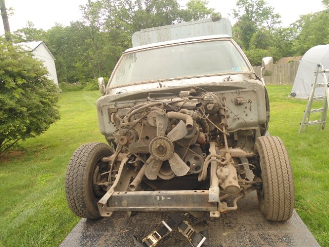

Where would the best place on-line, to find a printable under hood wiring diagram for an 86 D-250 with the ESC system (Which I'm doing away with)? Trying to do this as cheaply & as quickly possible. I'm working on it outside. TIA
Thanks for the info, but that will be my last resort. I'm trying to download a wiring diagram from different web sites & not having any luck. They either don't match my bulkhead connector wiring (Under hood is all I need) or they're wrong all together. I know 86-87 are odd ball years with some having the ESC & some not. I do have the under-hood connector, but the wires are cut off at about 6-8" or so. I don't want to spend the $70 bucks to get the shop manual just for that though.

Thanks Don. I have the vacuum adv. distributor, old style carb & ECU set-up & installed & set up temporarily just to get it running, (Runs great by the way) Just wondering where the wires, or what's left of them, from the bulkhead connector go. I might as well finish the wiring job as no one seems to be interested in it the way it is. Too bad, it's a very clean, rot free truck & a factory 4-speed too.
