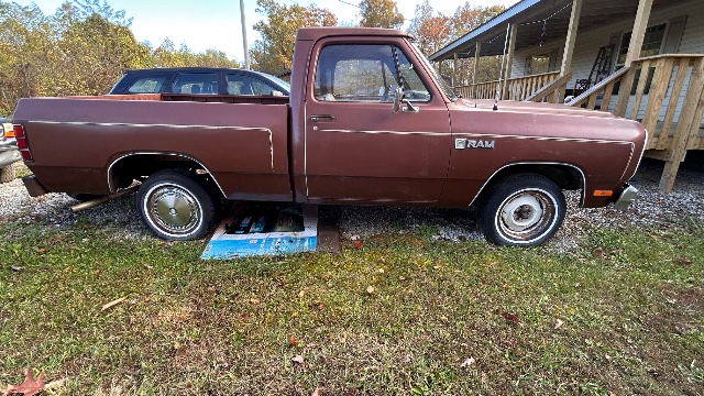

Will any 8 3/4 work?
70ChargerRT
Nov 12, 2025
Kentucky
Getting ready to purchase a 84 short bed with an 8 1/4 and Im wanting to put a 8 3/4 in it and I’m wanting to make sure those are direct bolt in with no problems in that truck. I can get a 9 1/4 but I like the 8 3/4 better as I’m somewhat familiar with them.
