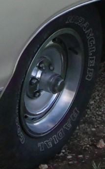

will the wheels from a 72 new yorker fit a 85 d 150?
Yes, they will both be 5 on 4.5 bolt pattern and 15 inch the back space will be close or the same I've put those rally wheels on my 82 I had years ago, they look nice.
Nope. They won't.
An 84 they would. They went to 5 on 5-1/2 starting in 85.
Oldmoparguy, it seems I was wrong I did not think Dodge moved away from the 5 on 4.5 until the early 90,s but Volaredon is correct they changed in 85, too bad as that rules out many nice wheels, I don't care for many of the newer bolt pattern in stock form but I guess there are plenty of after market choices.
