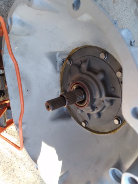

78 was 1st year for lockup, some had it, but not all. When you have the TC off its easy to tell if the trans is lockup or not. if the splines go all the way to end of input shaft it is NOT lockup. If the shaft is smooth and turned down a little smaller at the end and the splines start about 1/2" back from the end it IS a lockup version.
all the way til at least '90 they built some each way. My son's W250 with 360 (gas) factory trans is a 518 w/o lockup. Original trans in his 360 powered 89 Ramcharger is a non lockup 727. Though now it has a lockup version 727 in it from an 80 Ramcharger. My own 78 Sport Fury (318,904) is NOT a lockup. (very early build 78 in Aug 77) And still has a drain plug in the converter. I know they eliminated the drain plug in everything whether lockup or not, right around the time that lockup came out. no lockup converters ever had a drain plug (from the factory, anyway) info I remember from some old Mopar factory training manuals I used to have around here. and various factory service manuals.
Here it is
