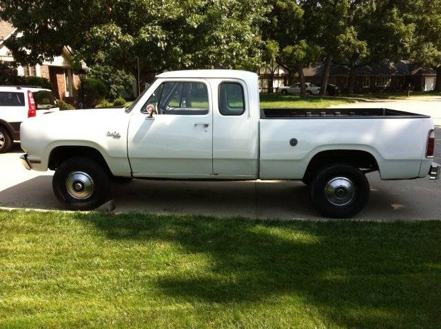

Have 74 W100 Power Wagon, Club Cab, short box. 318, "340" cam, torqueflite. Daily adventure driver.
Know of any disc brake kits I could use with my lockout axle?

Welcome to the site frank ! There's lots of Mopar guy's here , you should enjoy it . On your disc brake question . Don't you already have disc on the front of your truck ?
Oh yah , "Nice" Club Cab by the way .
