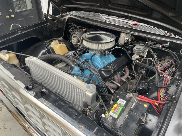

my 75 ramcharger had a 440 with pb ps air , was no fun to work on but it cleared the pb assembly . it's long gone without any under the hood pics . but does your booster look like this one on my 74 d200 with a 360 .

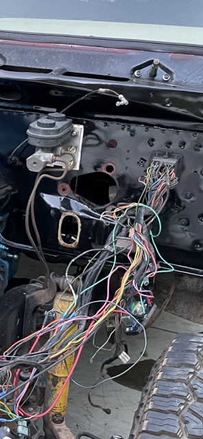

I know the 440 (RB) will definitely need the brake booster relocation kit if it was a small block truck, but was not sure if the 383 (B) would be able to clear. I was probably going with a 2” body lift to clear 33” anyway, so this would help also.
There is not that great a difference between the two. There were smaller booster even in the 80's.
There’s a 8” booster that was on some of the heavy duty trucks that will clear the 440 with no issues. I believe the parts stores refer to it as the “dual diaphragm” booster. If you use a body lift, the factory 11” booster will clear as well. Or you could do what I did and just delete the booster.
