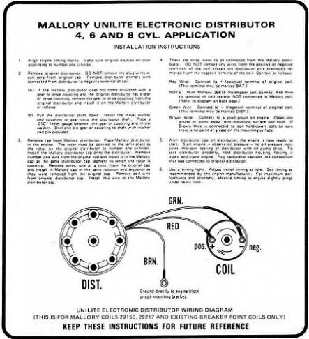

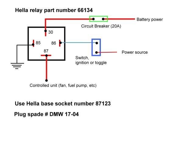

I'm working on converting a 1988 Dodge Ram 318 2 bbl throttle body to a healthy, 360 4 bbl carb. I'm adding a Mallory Unilite distributor. I would like to use a stock electric pump in my tank by using a fuel pressure regulator before carb. But, I can't get the pump on and there's no spark coming out of the coil (which is new). What am I missing here? -wiring wise.. does something need a jumper wire, or to be by-passed? Can anyone help? Please and thank you!
