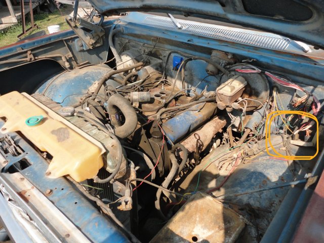

Without the ballast resistor you WILL fry your entire ignition system if it is by-passed, or nothing will work. It should be under the driver-side hood hinge. In the picture (circled in yellow) it's not bolted down like it should be.
Okay, I do have that exact same ballast resistor! Look at that kit and tell me if you think that's compatible though 🤣🤣🤣
