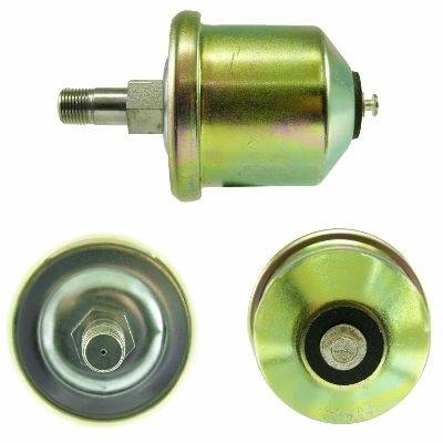

What you need depends on weather you have a factory gauge or an idiot light . If you have the light then they make a special socket for it but you can use a deep 15/16" like Chuckie said . But if you have the gauge and the correct sending unit was put in when you put the motor in then you'll need either a very short 1/2" wrench or even better a crows foot and you'll kinnda have to get under the unit it's self ( the stud part of the unit ) .
oil sending unit is where you said .but it does not look bad ,but full of oil the part it screws into is attached to a horizontal part (appears to be threaded into a part having a nut that a 15/16 wrench fits. My machinist neighbor sasy it appears to have oil on the horizontal piece. P.S. I still have the wrench he made me for the original install
Mine didn't LOOK bad either lol we both know what they say about looks.
oil presure.jpg You probably blew the seal that seals the stud and the unit because that's supposed to be all one piece or unit . They can make a roil mess when they let go .
