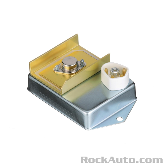

What does this have for a ignition system? Does it have a module like this one?
