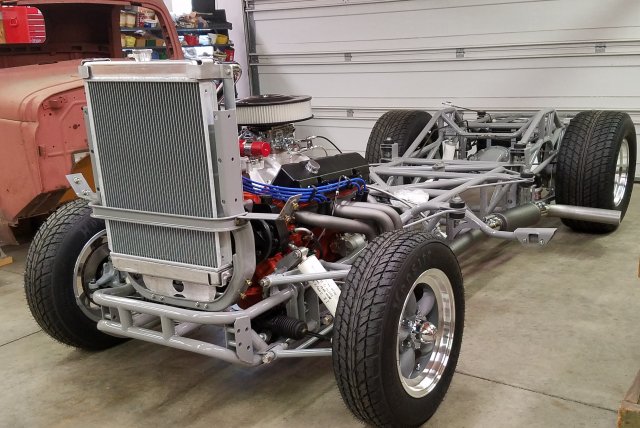

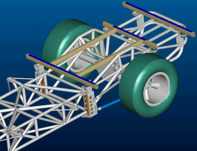

Custom tube chassis:
Designed on CAD and all parts detailed on drawings.
2" chrome moly tube
4-link rear
Custom front A-arms
Bus miter box steering w/Mustang II
Rack&Pinion
Shortened 8-1/4 Sure Grip Rear
(with girdle and 3:55 gears)
108" Wheelbase
4 wheel disc brakes
15 gal Jeep CJ fuel tank
Engine:
Stock 440 .030 bored
RPM intake/750cfm carb
Custom 1-7/8 headers to 3" pipes
Remote mt oil filter

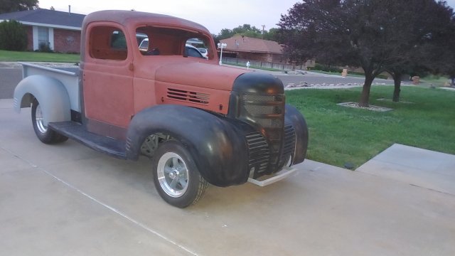

The front grille was trashed. So we

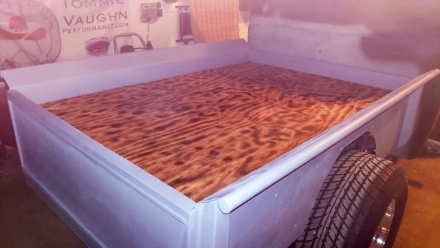

fabricated a new insert. Running boards shortened 8", rear fenders shortened 3". The bed sides are
from a '54 Ford.

We've also mounted the 4-link bars
using rubber bushings instead of
Heim joints to reduce the shock to
the differential housing.
