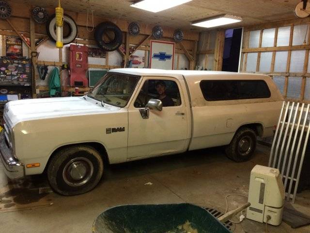

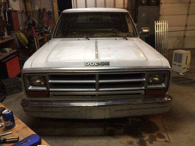

Well we got it figured out. When he chose his remote power for the vr/alt he chose poorly. After chasing wires and screwing with for a while I pulled his remote wire from the cab to the engine bay and connected it to the battery....Eureka! We had a charging alternator. He found a better spot in the fuse box and was back on the road! Here's a couple pics of his. 88' 3speed 318la w/holly FI. This thing scoots surprisingly well for a small block.
p.s I think I'm gonna move that large blue bow tie. I only seem to take pics of mopars anymore and in all of em there's my bow tie!
Well we got it figured out. When he chose his remote power for the vr/alt he chose poorly. After chasing wires and screwing with for a while I pulled his remote wire from the cab to the engine bay and connected it to the battery....Eureka! We had a charging alternator. He found a better spot in the fuse box and was back on the road! Here's a couple pics of his. 88' 3speed 318la w/holly FI. This thing scoots surprisingly well for a small block.View attachment 7880View attachment 7881p.s I think I'm gonna move that large blue bow tie. I only seem to take pics of mopars anymore and in all of em there's my bow tie!

Hey now!!;) That bow tie has fed 4 generations of my family. Born and raised in Flint MI makes kinda hard to escape it lol. Besides my aunt spent 2 days pealing that off of the wall in the old cheby in the hole plant that is now gone. She tried to give it to my dad for his retirement. He wanted nothing to do with it lol.

Hey , I can relate . Bow ties have put plenty of money in my pocket as well . Pretty much every one that has pulled up next to me , has had to give something up . ;) lol No offence Furyus , But you know I got to bust'um every once in a while and you left yourself wide open with the bow tie on the wall . :) lol

Yes...yes I did! No offense taken at all bear. I figured if I didn't call it out someone else was going to lol. I'm a car guy tho. They all make something I like. I just like Mopars better!! From my great grandfather to my father, all retired from cheby! I did a spell in a cheby plant myself....never again tho!
