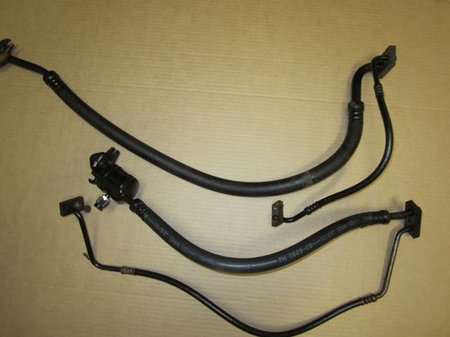

Now my options were to find an NOS hose or after market
replacement. No NOS ones were to be found. I could only get one replacement hose
and it was not the one I needed. So I started the google search. A/C hose repair
brought up two websites. That night I took pictures of the hoses and sent them
off to both companies. Kelly with Estes Automotive was the first to reply with a
price and the correct answer that my hoses could be repaired.
I
sent them out Wednesday and they got them on Friday.

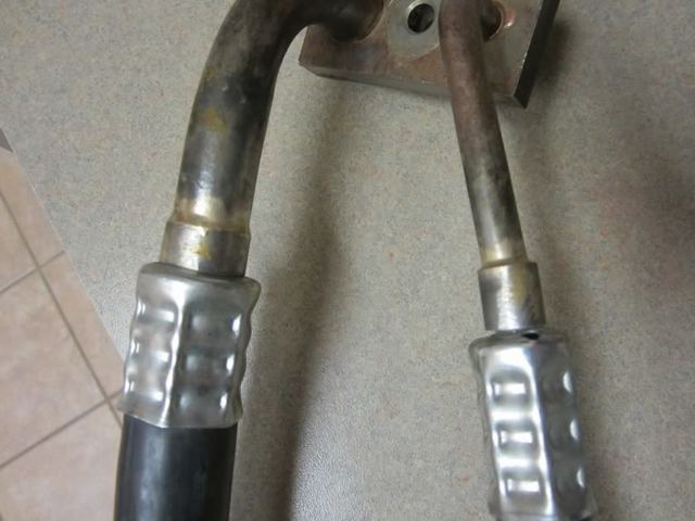

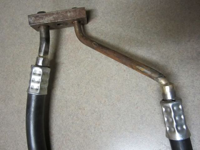

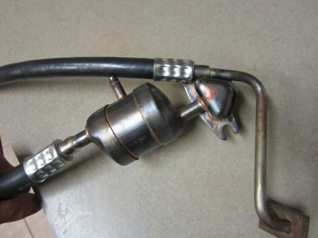

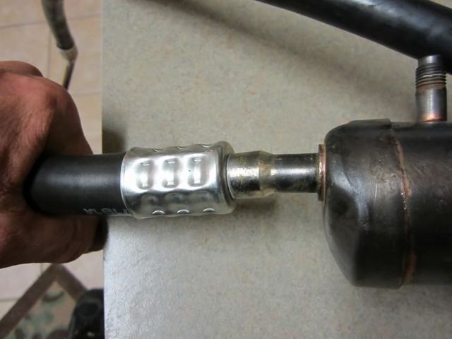

Well after stripping the paint off of them this morning this is how they look. I
cleaned the rust off of them tonight and they are ready for paint tomorrow
morning.

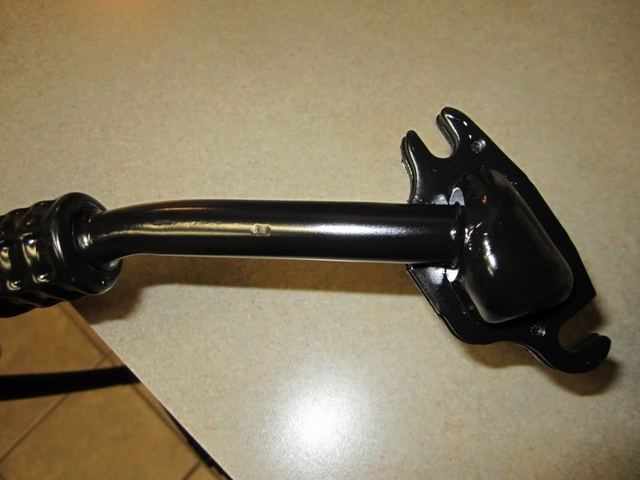

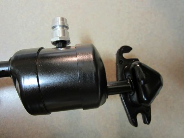

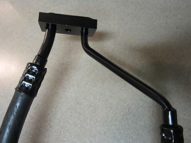

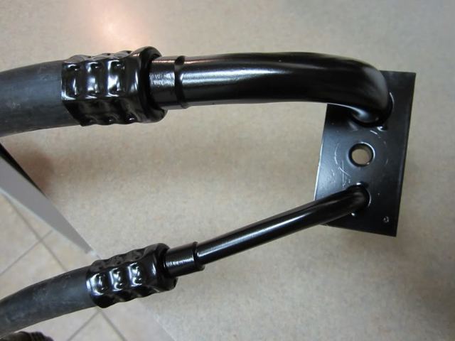

I got mine all cleaned up and painted today. Glad I stayed with the stock
looking ends and just had the hoses replaced.
