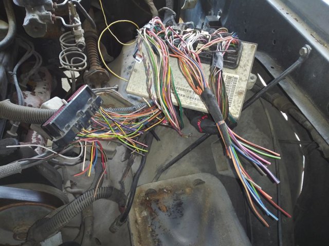

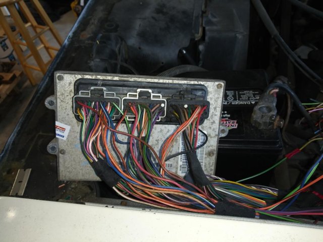

I did a lot of searching and didn't really find anyone that has done this without the $1000 Hot Wire Auto harness so here it is. I used the 3 JTEC connectors from a 99 1500 4x4 automatic truck and spliced them into a 93 5.2 Ram Charger harness at the 60 way connector. I didn't change any sensors on the OBD1 engine or the harness. I obtained the data link connector from the donor truck as well. I did the conversion in the RC to get it up and running and then it will all get swapped into my 74 W200 crew cab stick truck. So if you have an OBD1 Magnum or you have one swapped into an early truck and want to be able to flash the PCM for engine modifications (cam, intake, heads, stroker cranks and even forced induction) this will work for you. This way you can keep the factory injection system with it's diagnostics and readily available parts.
A note on the JTEC connectors, they are labeled in the FSM as C1, C2 and C3, they are all 32 way connectors. If you are looking at the PCM, connectors facing you and at the top the connectors are labeled right to left, not left to right. So C1 is on the right, C2 is in the middle and C3 is on the left.
To document this conversion I'm going to post the JTEC connector number then the cavity numbers underneath on the left. The wire color and circuit, then the corresponding SBEC 60 way connector cavity on the right with the wire color only if it's different. Once you remove the plastic covers you can see where the cavities are numbered at the end of each row, this includes the 60 way connector as well so it's pretty easy to figure out. Just take your time, do one wire at a time and double check that you are cutting the correct wires.
