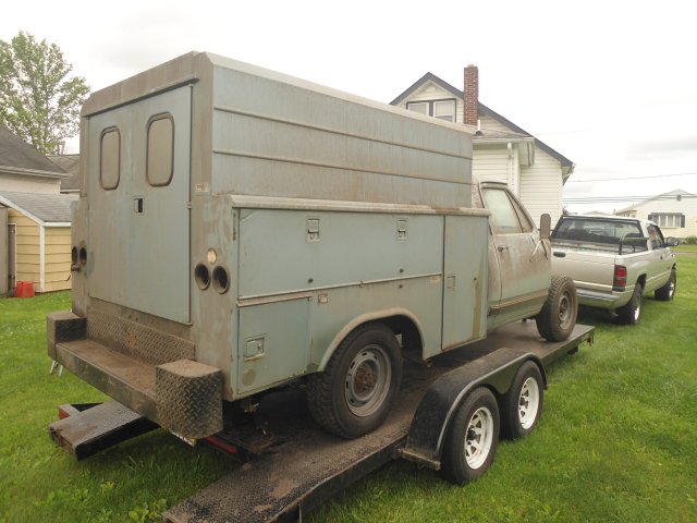

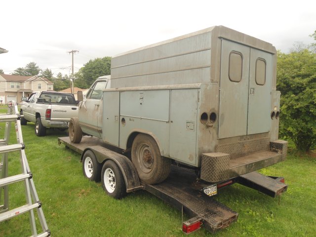

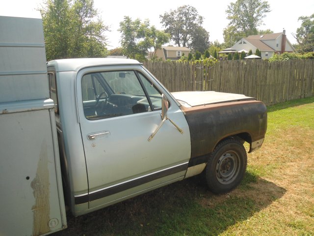

This is before I power washed it. It had way more dirt & dust on it before I trailered it home. It's a very solid truck.

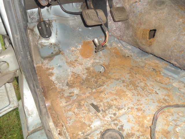

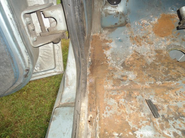

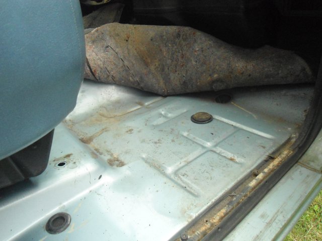

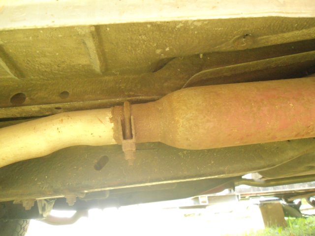

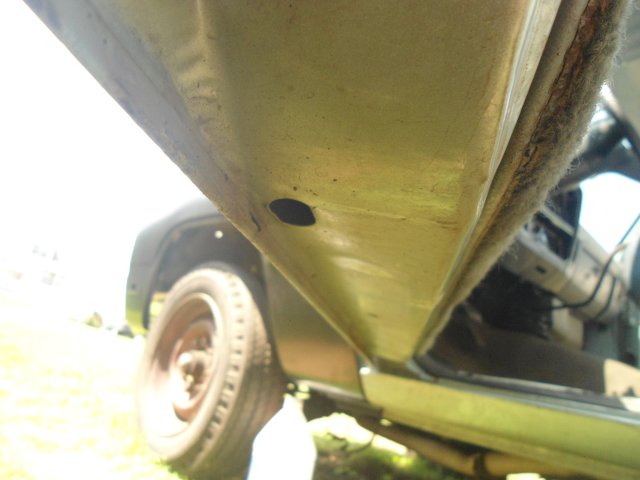

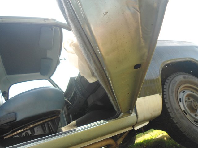

This thing is SUPER solid all around, especially for a Dodge truck from the rust belt. Sitting inside well over half its life surely helped it. I'm working on getting the seat out & will need a friend help doing so, as to not damage the mat or sound deadener with the studs of the seat. After I remove all that stuff, I'll get more pics of the floor & body after a good cleaning. I'm still shocked at how clean this thing is, even underneath. I hit the jackpot on this one. The enclosed utility body will be sold for sure.

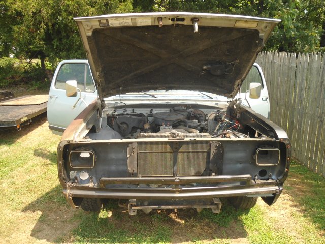

Why didn't they fix it 25 years ago? Bent frame? I'd start that thing up before I power washed it or did any other major work.

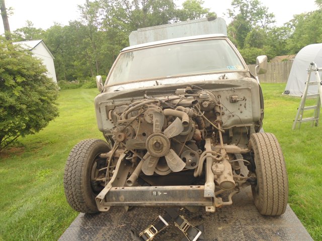

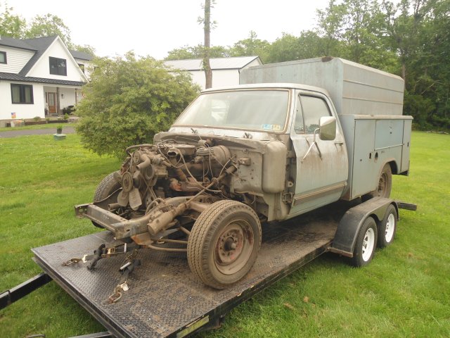

Easier said than done. I don't know why it wasn't fixed. Lost interest maybe. I checked it over to see any frame damage & only found the right upper frame rail tweaked down a bit, that's it. If you look closely, you'll see the wire harness coming out of the cab has been cut off, along with some other wires, & what you see is how the truck came, no front sheet metal, now harness, it was all MIA & I could not find any of it, that's why I haven't gotten it running yet. It was covered in dirt & dust from sitting so long & needed a good power washing before I started doing anything. I will get it running before I spend any money on it but also seeing how bad any rust is too. This thing is solid & I'm convinced it should be fixed. I took more pics of the floors after moving the rubber mat aside. You don't find trucks this clean in the rust belt, where I'm from.
I don't like to power wash an engine I can't start right back up. Too much chance of getting moisture inside that might damage things. Good luck!
I see the wiring unhooked from the engine Long ago some people would take the front end off to change a engine
From what I was told by the owner's nephew, it was in an accident & that's why the front-end sheet metal was removed by the guy. I don't know the full story but, in seeing the great condition this thing is in, I'll put an engine in it if I need to but, I don't think there's a problem with it running well. I don't get some of the things the owner did when he removed the front end but at this point, I'm going to see what it takes to get it running first. I have everything I need in my collection of Mopar stuff, so it won't cost me a dime to hear it run. I'm getting rid of the pollution control stuff first to swap over to regular electronic ignition. I am also selling the Reading utility body as it's in good shape & I have the keys to the door locks, & they all work.
If they cut it off on the engine side of the bulkhead connector, make your own engine wiring harness from that point on. I had an 84 D350 2WD with a 360. It had an additional connector between the bulkhead and the alternator. It eventually burnt that connector up, so I rewired it without it, doing all soldered connections and heat shrink. Truck ran great afterwards. While you have good access, check the drivers side frame rail at the steering box to see if it is cracked at the box. My 88 D100 is cracked so bad at the steering box that the box wiggles when you turn the steering wheel. I'm gonna fix it when I 5.9 Magnum swap it. Good luck with the project! 👍
Well, I finally got a temporary ignition set up on this thing to see what it sounds like. YES, I did by-pass the fuel tank & ran a hose from the fuel pump pick up, to a gallon jug of fresh fuel, changed the oil & filter, pulled the ESC carb & installed one from a 69 D-200 I had, primed the oiling system etc. etc. Checked the frame, where the steering box mounts especially, & all was well, very well actually. I sprayed some starting fluid down the carb, after sitting for almost 25 years, this thing fired right up, sounded great & idled good, so I installed the front sheet metal that was missing from it when I got it, (See all text & pics) with mainly original Chrysler fasteners I have. I was going to keep it as my work truck but, the truck is in too good of shape to use for scrapping & stuff so, I'm going to sell it. If anyone is interested, I'll give more details & pics via PM that you want.
