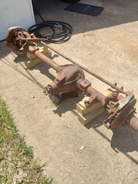

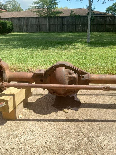

Jeep front axle?? Can anyone ID this thing for me and what it might be for??

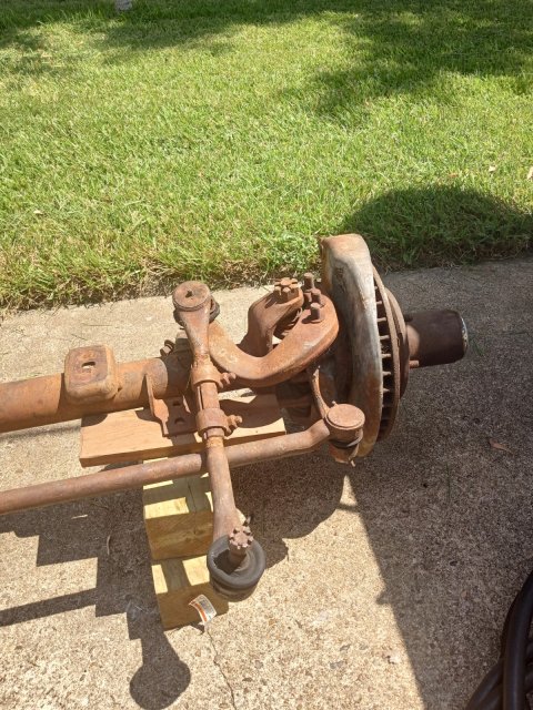

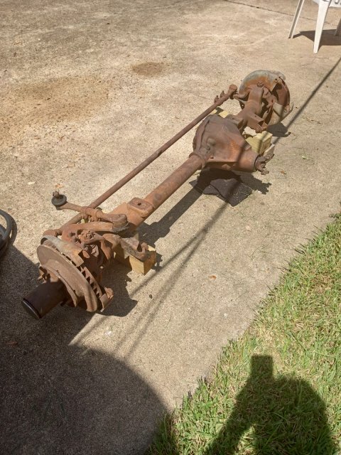

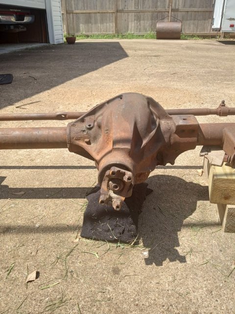

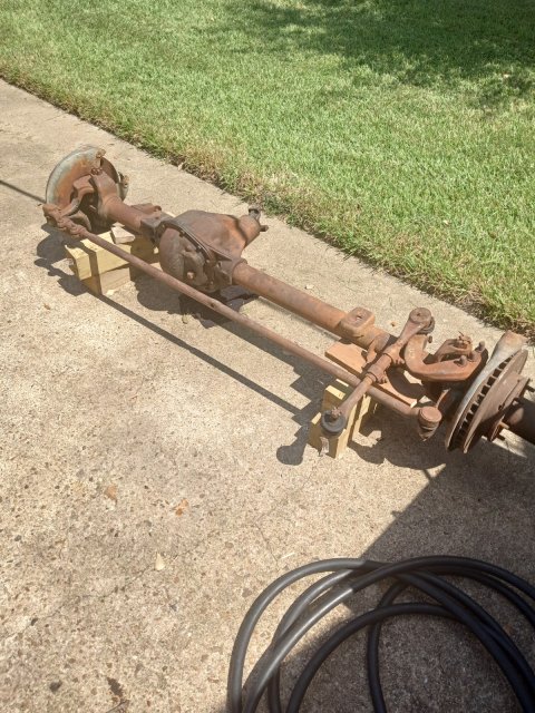

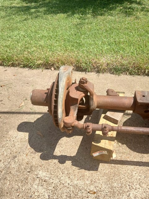

At first thought, late 90's TJ but those have 5 lugs and this has 6....
Dana 44, looks like a 73-81 full time 4wd Chevy or GMC K-10. J-10, Wagoneer and Cherokee 73-91 also used the Dana 44 in the front, but the drop was on the left side and the spindles are different.
